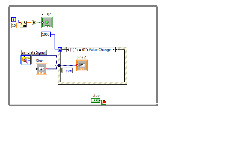

It works pretty good, but what about doing it with and event structure?
I try a couple things like creating and event for when the reminder is zero but that didn't work.

Assuming you have a timeout case in your event structure, you can check the status of the remainder every iteration. Make a value change event case for a boolean, and whenever your remainder equals 0, just set the boolean's value using value signaling to generate the value change event.

I actually did that but I can not get the data to record...
Message 7 of 12
(4,926 Views)
Let me rephrace that... for some reason the event (for boolean value change) doesn't execute.

Guru,
why doesn't it stop?
The timeout is connected with 1000ms so it will stop after 1 sec, doesn't it?
roddy,
it's right that the event-structure does not execute if you connect the control directly (as you did).
Try to connect the control using a property node and its property value (changed).
This will trigger the event-structure.
(Maybe you should use the LabVIEW help. I'm pretty much sure there is an example in it how to programatically trigger event structures)
IMHO it's not a smart solution anyways. The idea of a event structure is to capture user events (i.e. the frontpanel activities).
In your case it'maybe better to use a timed loop with 1000ms loop time,  replace the event-structure with a case-structure, take the Rest from your modulo division and connect "Sine2" inside the case "0" of the case-structure.
When the Rest of your modulo division is != 0 then nothing happens.
Rainer
