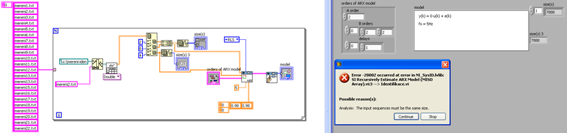

Hello. I have problem with recursive MISO Array. Stimulus is 2D array and response is 1D array. This arrays are same lenght.After run write error 20 002. I don't know where is a problem. Please help me. Thanks

Here is the picture in original size and vi is in file ident.zip. Excuse me my horrible englisch

Hey Mizda,
Your B matrix and Delay matrix were incorrect.
The B matrix should be scalar, and Delay matrix should be initialized (it can be 'zero', but it can't be empty).
Please, check this simple example!
