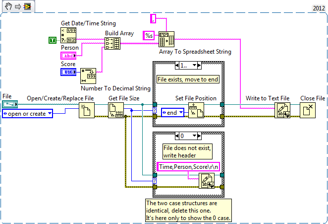

The easiest way to do this will be using a tab- or comma-delimited text file, which you will be able to read in Excel. Then you need only open the file, set the file location to the end of the file, and write the new data. See the attached example code, which you can drag into a block diagram. Set the filename and other front panel controls, then run it. Change the name and score, and run it again. Then open the file, and see if it's what you expect. Here it writest the time instead of date so you can run it several times in the same day and see the difference.

Je n'ai pas trop compris vos exemple, avec nouveau fichier le chemin excel. Pouvez vous etre un peu plus précis s'il vous plait? je suis plutôt débutant en labview.
Je vais testé l'exemple avec l'image PNG.
