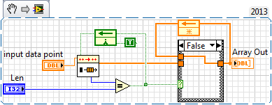

Peeking under the hood that is the intended behavior and the value of data index should be -1 and never have been exposed to the user.
But what intern used Trigger and gate with block diagram constant sentinal values under the hood?   Its nearly write only code
Replace that repak with this:

Hi Jeff
Many thanks
I try to build this vi in 2010 but I couldnt find all components.
Can you send the vi for 2010 or it is only valid in 2013?
Best
cp

I'm mobile now. The subvi Is data queue pt by pt search pallets and find it easy.
Perhaps another poster would be kind enough to back save it.
Message 9 of 14
(4,362 Views)
I found it, thanks
