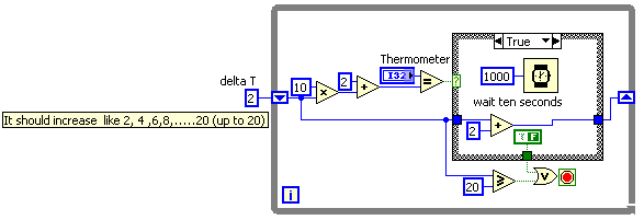

First of all, your sequence is completely redundant.  There's other things wrong that I don't know how to type up.  I wrote a VI that does what I think you're looking for.  Hard to say though.  Give it a shot.
untitled.PNGYou'll have to replace the 1000 with 10000 for 10 seconds.

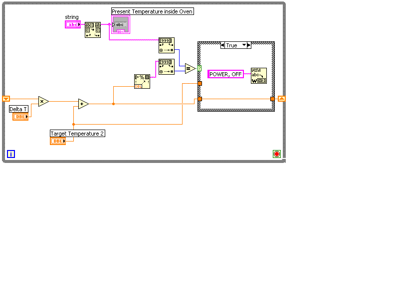

thanks for your tips. But unfortunately its not wrking with me. Actually what i have to do is with RS 232. I am heating up an oven up to a particular temperature. I give the starting temperature and the oven heats up to that temperature. I check this by retrieving temperature from the oven. When that particular temperature is reached, i switch off the oven for 10 seconds. Then again i start the loop of heating the oven to another temperature. This new temperature is increased by a factor of Delta T. ( New temperature = Start temperature+Delta T). Now the loop goes on same as in the previous case and switches off at the new temperature.
This is what i wanted. See the below VI or screenshot

Your shift register has no purpose, because you never change it's value inside the loop.

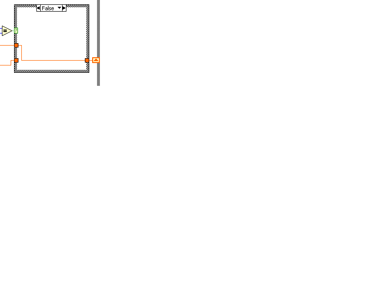

Indeed, you never update your shift register in your VI. I have adapted your program to reach your needs. Smiley Happy
I hope this helps,
Laurent P
