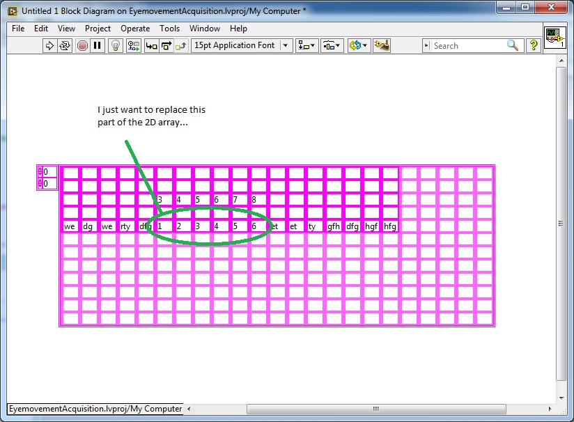

replace 1d array at specific point in 2D array
I have a 2D array with alot of information and only want to replace some data at a specific point... see image:Schermafdruk 2014-08-26 09.53.17.png
When i use replace subset i can only replace one element at a specific row and column...

I think i allready got it... Without a loop!!
I use index array on the 2D array then i use replace array subset on the 1D array, here you can give an index and replace the 2D array again with the newly formed 1D array!

The correct solution is to change the small 1D array to a 2D array and use "replace array subset" with both indices wired.
It requires a 2D array such that the function know if it needs to replace going down or going right from the given index. It cannot deal with a 1D array directly, because the operation would be ambiguous.
Here's what I had in mind.
(If you want to replace down the column instead, simply add a transpose after the build array node.)
