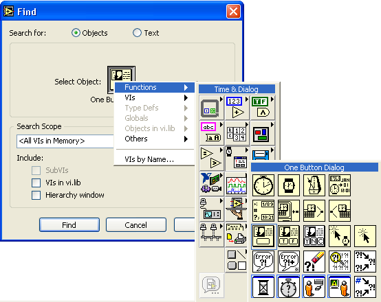

I am trying to use the Find feature to locate all one button and two button dialog boxes in my VI so that I can replace them with my own message VIs.
This is a large application with many sub VIs as well.
I am having no luck finding them programatically and have to search manually.
Does anyone know of a way to find them?

Use the find vi.  Hit control F and then select the one button dialog under functions.  If you make your replacement vi with the same connection pane it will be a simple exchange.

That seemed like it should work, but the NI core one-button dialog does not appear in the availablie VIs using the find function.

Thanks Dennis, I was foolishly looking under VIs and not functions (I guess that I qualify for the "Duh" award).

Another trick when yuou cant find the vi is to place one down on your diagram and highlite it (click on it) then hit control+f this will bring up the find dialog with the function already selected.  The find tool is a great tool but is not used enough by many programmers.  The find text is graet for commenting code that has to be fixed or altered.  I will put a label "<Todo> fit this code ...more here..."  on my diagram then I can search for the <Todo> text and find all places in a project that I have not finished.
