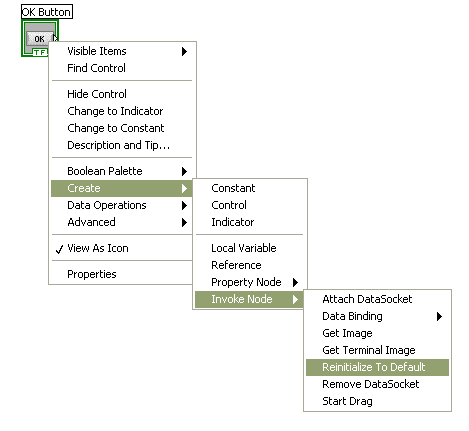

need is how to get the bottonto reset when another botton is pressed
You can use a invoke node like this

(Please ignore the two anwers above, they make no sense and just complicate the issues.)
