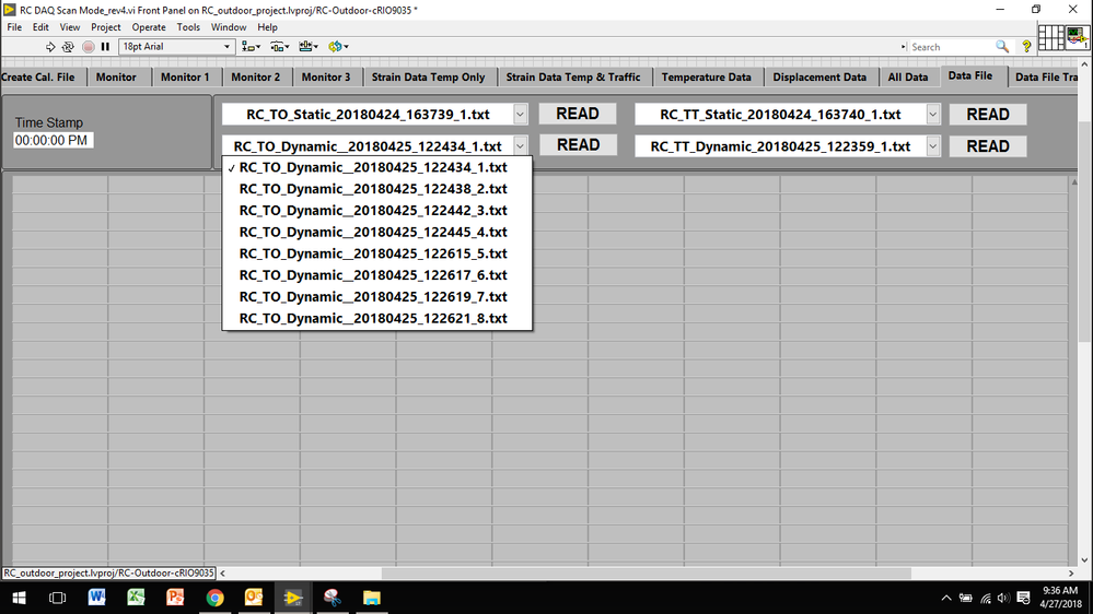

Hello everyone, I have a menu ring which lists all the files generated, the file is named by date, time and increment number, how can I reverse the order of the list, make the newly generated file always appear in first place. Thank you. Screenshot (7).png

The elements of the ring are saved in an Array.  All you need to do is re-order the array and put it back.  I created a Ring control with the strings One, Two, and Three, ran this code, and it became Three, Two, One ...

Something must have loaded the items into the menu ring.  Why not reverse the data going into it?
