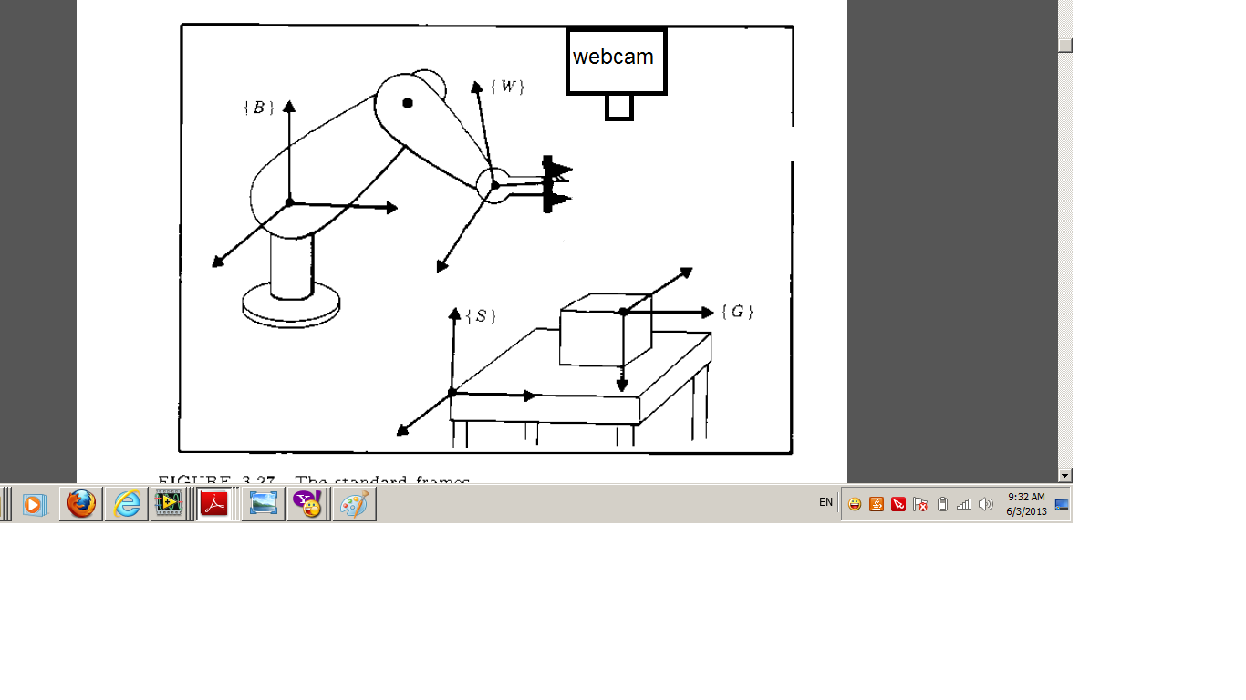

i try to bulid this system using labview it simpaly pich and place an object on the table, the location of object found by camera relative to frame on the edage of table
i have D_H parametrs of the robot
does any one have information about this type of system

First of, an excellent project to work with! Now, do you have the actual robot with you or are you simulating the robot? The picture you posted is of an industrial robot I believe, with 6 joints. PUMA, SCARA and my personal favourite the ABB iRB all have 6 joints.
As I understand your quextion, you say you want to build the robot, then the robot have to be programmed using LabVIEW to replicate your current D-H parameters for the 'pick-and-place' operation?

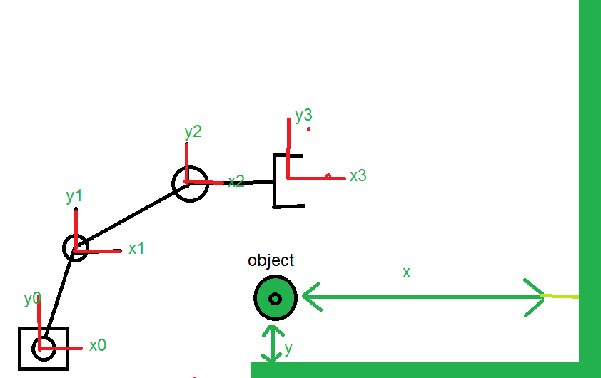

Dear member
thank for replay
to simplify the problem I draw this figure as below
I have the physical robot which is take from here
http://www.robotmatrix.org/lynxmotion-robots.htm
I have build the vision system using labview to find the object  center position relative to base of of robot as shown below
I have the D_H parameters of it
I have the forward transformation matrices from gripper  frame axis (x6,x6) to base frame Axis (x1,y1) of the robot
my goal is to  to convert the object position (X,Y) to angle OF ARM so that the gripper become at  object center???
also did I put the link length in centimeter or meter in transformation matrices???
also to to simplify now the object all ways lock like  acircle
best REGARDS

Hello mangood,
I am not familiar with the vision system you speak of, but considering the fact that the robot base (your X1, Y1) will not move, to find the position of the object centre to the robot base is a good idea. (BTW, most folks take X0, Y0 as the base and work their way up!).
To start with, you need to also give the posistion of the object centre as one of the intermediate positions of all the axises.
Example, from current position, to this intermediate position (on top of object for example), then another position to grip object and then another position to drop the object.
In the D-H method, you can find the Link lenghth and the angle of the joint, is this what you mean?
You can put the link length anyway you want, except that it has to be uniform throughout your implementation.
Thanks, get back on those.
