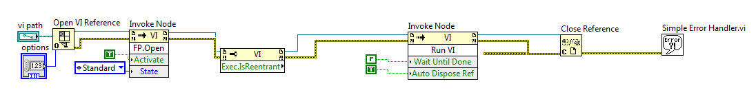

But via this code I want to open and run my subVI:1.PNG

I come to think that my failure is somewhere in the posted code snippet.
Opening the front panel via a button & event case works.  I just would love, if the subvi would already be running. Additionally I would like to know why the subvi opens another front panel when I click the run button of the subvi's front panel? (Yes, I know, it's because I am doing something wrong - but do you have any suggestions what it is?)

Hi Lotusblüte,
First run the VI, the open the FP…
You (or the user) should never be able to click any run button in an application. Hide the edit bar!

Hi Gerd
Thanks for your idea.  When I change Run VI and Open Front Panel it opens the SubVI running. But as soon as I choose a path for the Excel Files it stops running?
I build a smaller version of my subVI (yes, I know it does not fit the Labview guide Smiley Embarassed ) But I hope it gives you an insight of what it's doing

Hello lotusbluete,
in my test the example vi does not stop, when i select some excel files.
I have replaced inside the example vi the open open vi reference with the vi reference, also some vi´s are disabled so i can run the code. For the test i used a test vi to start the example vi to better debug the behaviour.
Attached the files.
best regards
Alexander
