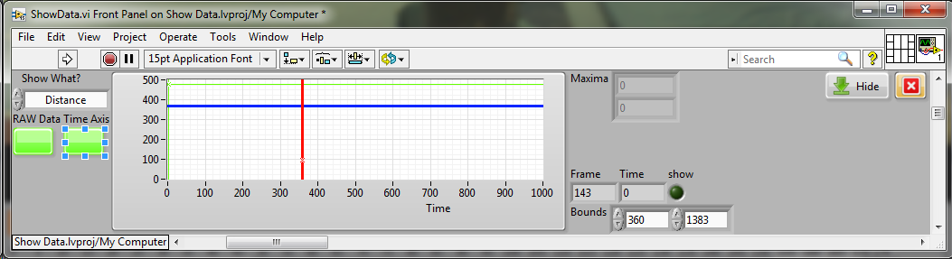

Something really wiered.. When I run a program (a specific one) the vi starts running BUT not completely! The buttons on the forntpanel do not work and the RUN and ABORT button of labview are both active (not grayedout). See image. The timeout of the eventhandler is working fine (as I can conclude form the frontpanel)

@J_Snow wrote:
Since I do not get any error messages, I have no idea were to start looking. Anyone?
... and since you provided no code for us to run (which would, among other things, answer such important questions as "Which Version of LabVIEW is this?" and "Are you using specific Toolkits, Devices, etc.?", we also "have no idea where to start looking."
Please provide as much code that you think will duplicate this issue as possible (everything would be great!).  If it is more than a single VI, put all the code in a Folder, compress the Folder, and attach the resulting .ZIP file.  I can assure you a number of us will try to help ...
This can happen if you use non-typical priority settings. For example if you set the priority to timecritical, front panel re-draws are delayed to favor computational tasks.
We probably need to see some code. Is everything masscompiled?
Most likely this is a cosmetic, not a functional issue.

Why is the front pane so gigantic? (9308x6554 pixels!)
Why is the tab control so gigantic?
I would resize them to something more reasonable and try again (sorry I cannot run it because I am missing some of your toolkits).

I don't have vision installed.
there are other things wrong with this, for example I cannot get any menu when I right-click any terminal on the diagram.
I really think that the oversized front panel is the problem and somehow interferes with the redraw operations of the toolbar and other edit funtions. You seem to move the origin around in the init case, and maybe this changes things.
After trying to right-click a few more terminals, LabVIEW 2015 actually crashed for me, so something is definitely wrong here.

Yes I agree. The panel keeps getting bigger everytime I run the vi. I have no idea why.
What I try to do with the origin is fix the panel at a knwon position so that I can scale it depending on display size. The visible area is quite small so I want to be able to 'look' around through the vi front panel while building and still be able to get the right view of the frontpanel when I run the vi.
Does this make sense?
I striped the vi of almost everything. So panel stay the same. But still the same problems when running.
So now I have two questions (1. Why does the vi behave so wierd and 2. who can I make a better scalable frontpanel)
