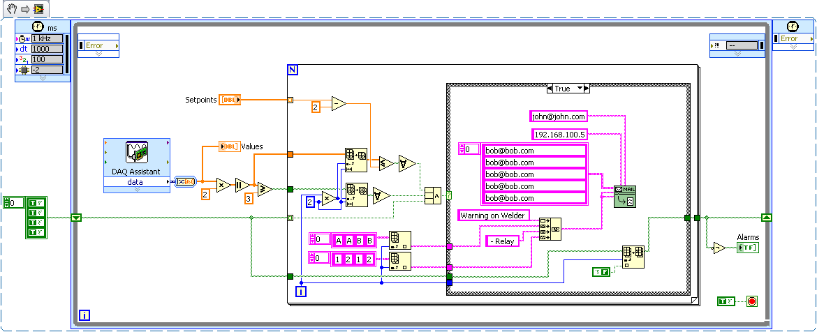

Hi
Something like this maybe:
This VI should have the same function as yours, but only send one email per error. I say "should" because I can't test it properly without a mailserver. There are most certainly a couple of bugs in there, but I hope the main idea comes across. What is missing right now is a way to reset the alarms. As it is now when an alarm has triggered it will remain triggered until you restart the VI. Hope this helps you in the right direction

I tested that snippet and it seems to function partly. It only alarms on the 4th set point change. I am trying to figure it out as it is a much much neater way of wiring up my program.
I also have just started testing the program on my actual system and have noticed a problem with my programming. The voltage is not always on they intermittantly kick on whenver the machine I am monitring requestes heat. When it kicks on the voltage steps up from 0 to 6, so as I have it programmed now it warns when its on the way up to the specified voltage. What I need to do is take only the peak and compare it to my set point and ignore when it is 0. Sounds confusing but that is about the easiest way to explain it.

Hi again
Had some time to do some tests. I'd forgotten a shift registrar on the for loop. I also replaced the e-mail with a popup (be carefull not the get caught in popup-lock) and the DAQ Assistant with a manual input so you can run test easier. Here's a snippet:
If I understand your intent correctly you just wnat to compare the peak value to the setpoint? As you are reading the values one at a time you would have to save them (maybe in a shiftregister) so you can compare the current and previous values and find the peak. Or you could read more values at a time and use some built in functions
