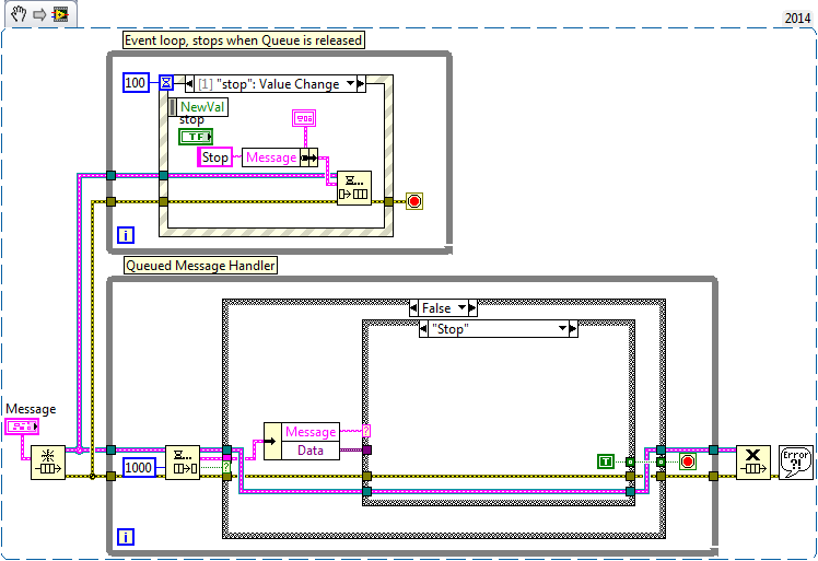

A couple of things.
  • The classic Event Loop is a While Loop with a single Event Structure inside it.  The Event Structure has all of the Events as separate cases, including Menu Selection, Value Changed (used to detect Front Panel interactions), etc.  Your VI has at least three!!  [There was recently, meaning within the last week, probably, a response in the Forum to an Event question that referenced the article that discussed why "Only One Event Structure" was so important].
  • Typically, with Event structures, you have two parallel loops, one the Event Loop that decides what to do, and the other a State Machine or Queued Message Handler that handles the details of carrying out the Actions dictated by the Event Loop.  Again, there are clever ways to combine these two loops into a single loop (one is to use User Events, a slighly-more-advanced topic, to make the Event Structure handle Actions-as-Events, the other is to put the Action Engine in the Event Structure's Time-out Event).  Personally, I find using something like the Queued Message Handler and setting up a Producer/Consumer loop pair, with the Event Structure being (mainly) the Producer and the QMH being the Consumer, easier to follow and implement.
  • Never (what?  Never? ... well, Hardly Ever ...)(if that suggests a tune to you, give yourself 5 extra points) use a Stacked Sequence.  Having connecting wires going all over the place, not being able to see what is going on (because they are "buried" in overlapping Sequences), and not having "self-documenting labels" (like the Message Names in the Queued Message Handler, where a Case statement controls the various "Actions" or "States" or "Messages" (pick your metaphor) being processed) makes the logic that much more opaque.
I decided that I need to add 1000 words to this post, so here is a "Picture", a Snippet of an example Event Loop + Queued Message Handler.  Your code should fit easily into this structure (if you don't know about Queues, feel free to ask, or go on the Web and search ...).
