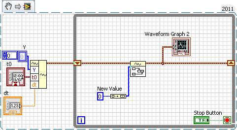

You do not need the wait til next ms multiple or Loop delay.  the VISA Read will throttle the loop for you (as well as all the UI thread switches inside the loop).
You should use Append to waveform.vi rather than build the waveform from scratch each iteration
See example
But the bigest reason you are loosing data is the insanity of disabling end on term character of new-line and throwing out most of the data with the Pick line primitive wired to the line index control?  Don't you want every reading?
