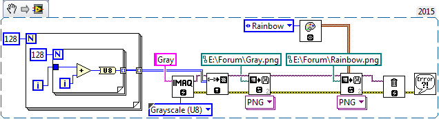

But while writing this Response and about to "apologize" for making you wait, I realized that while I had, indeed, "colorized" my Image (as verified by displaying it on the Screen), I'd forgotten that the goal was to save the PNG as a colorized Image.  So I added the PNG Write function, saw the "Color Palette" input, and said, "Hmm, I wonder ...", which leads me to this:
I chose to work with U8 Grayscale Images.  A difficult-to-find note here, from the LabVIEW 2010 Vision Manual, explains that PC displays can only show 256 levels of Gray, so U16 Images need to be "remapped" to a U8 range before visualizing as Grayscale.
The nested For loops generate a 128-by-128 pixel "Gray Gradient, with 0 (black) in the upper left corner and 254 (white, almost) in the lower right.  That's the Image I will use, writing it out as Gray.png.  The IMAQ Write File 2 (IMAQ functions changed a few years ago, many taking a "2" suffix) has a Color Palette input, and IMAQ provides a few standard LUTs (which it calls "Palettes"), including "Rainbow", using the IMAQ GetPalette function.  I wired this up into a second Write File 2 function, and the results are shown below.

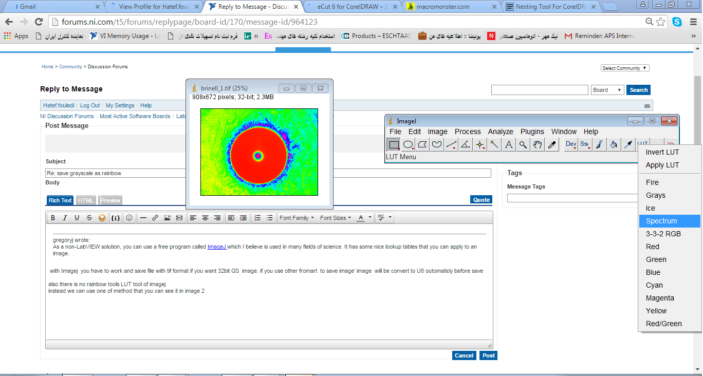

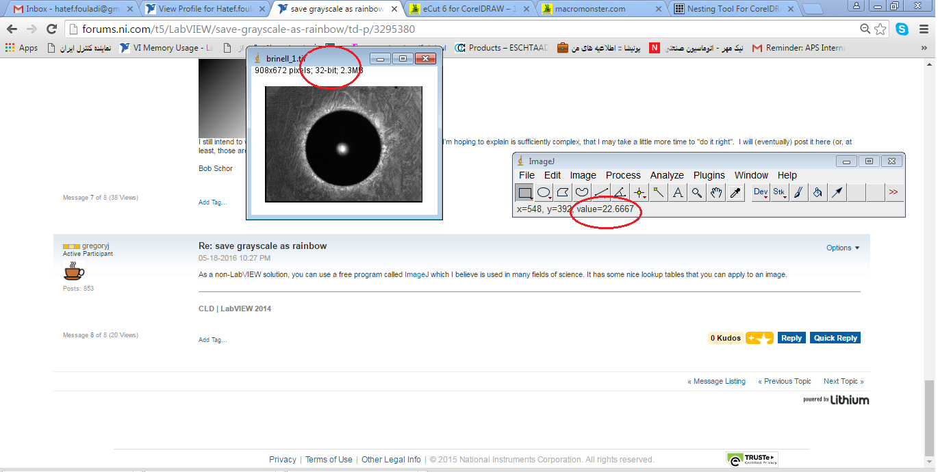

As a non-LabVIEW solution, you can use a free program called ImageJ which I believe is used in many fields of science. It has some nice lookup tables that you can apply to an image.
Message 8 of 12
(10,186 Views)
 with Imagej  you have to work and save file with tif format if you want 32bit GS  image. if you use other format  to save image' image  will be convert to U8 automatically before save
also there is no rainbow tools LUT tool of imagej
instead we can use one of method that you can see it in image 2
but for labview you have to save image in binary mode or inside the text as matrix

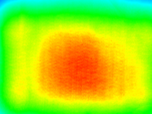

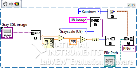

Hi All,
Thank you for your reply,
After I study your posts, finally I managed to convert grayscale sgl to rainbow
the trick is to rescale the image
here i attached my code and result
