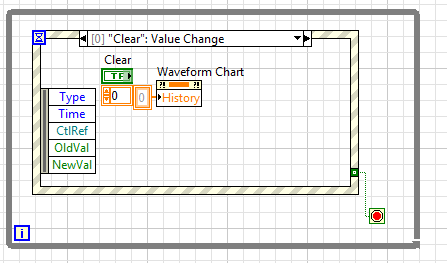

Fairly close.  You forgot that latching booleans need to be in the event case that reads them-  A chart works better than a graph and you never provided for a stop event.  The User interaction is enough to throttle the loop and the wait is not required.
No LAVA CCT here so a snippette would be unusable but I did attach the modified code (Saved to LabVIEW 2011)

Actually it's still not quite there, sorry for being hasty. Now when I press save, only the most recent measurement is saved to disk. How can I make it so every data point showing on the waveform chart can be saved?
(3,807 Views)
Just get the chart history instead of using a local variable.  You do that with a property node.  Look in the Clear case, copy that property node, change it to a read and wire it up appropriately.
(3,801 Views)
Or simply right-click the Local and Change to Property node
