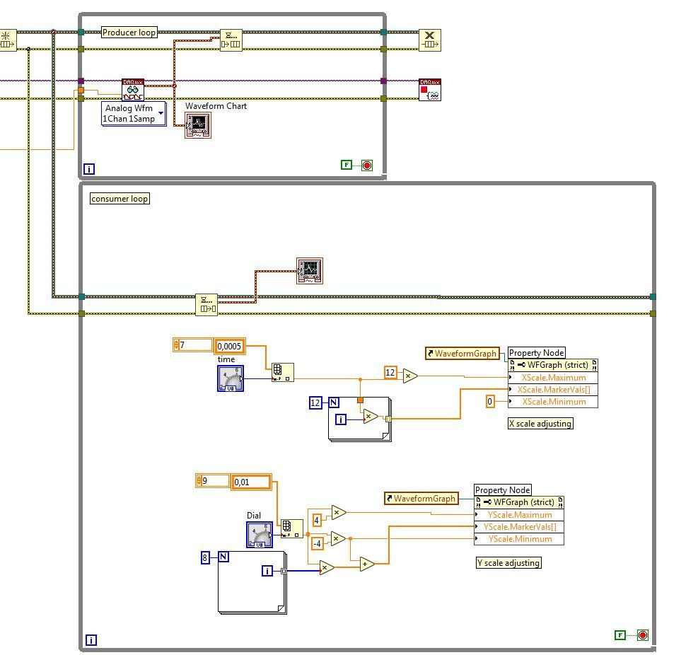

thank you a lot for your reply and explanation.
Producer/consumer architecture looks as very good, but this is totaly new for me (and generaly labview), so i am stuck now with adjusting X, Y scale.
I implemented one graph in first while loop to see ho sampling is working.
Problem is in second loop, because i get nothing on graph.
Also in att.
Thanks.

Hi milan,
Wrong: you get something in this graph!
(Change the plot style to show points for each sample to see a point in your graph!)
Why do you use a graph instead of the chart? And why did you hide/delete the label of that graph?
