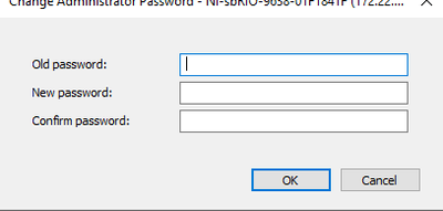

I only work on sbRIOs and set passwords all the time and I have been able to change passwords as needed.
Set Permissions to change password.
Is your sbRIO running in safe mode? I think the first password has to be set from web configuration and after that you can change it from NI-Max. Make sure your sbRIO is not running in a safe mode and has base software installed on it.
EDIT: oh and I just looked at the image you attached. Your inconsistent IP settings could be due to the static settings that you have. I did change my IPv4 address settings when I was first playing around with RIO boards was getting same message. I do not recall exactly what I did to resolve it but I believe is has to be set to:
Unless you have set rest for the settings correctly. Which would be IPv4, Subnet Mask, Gateway and DNS server.
