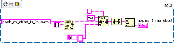

I have a string hkadc_bin2_offset_gain_check_9p6m.csv out of which i want to extract only 9p6m , i have done this using match expression and string to array function but i want to know if we can do the same by using scan from string or with match regular expression with correct format i am not getting how to use the format string.
Below i am attaching the vi in which i have done this using match expression and spreadsheet string to array, i want to know if there is any more better approach to this.

if the item you look for is always the last in the string you can use IndexArray instead:
And: DO NOT delete labels of controls/indicators! You may hide them (in the context menu)...

Thanks GerdW for the reply,
but i just want to know is there any way of doing this using scan from string directly by specifying only the format string means if only we can do with scan from string wothut using all other functions,
i just want to know if we can do by this, because i treis with scan from string but since i have never worked nuch with this function so able to use correct format to separate the characters in strings.

Hello RC,
this is not possible with the "scan from String" function. Use the "Match Pattern" function instead, with "[0-9].[0-9]." as search pattern. This searches for the following pattern:
[0-9] : a digit
.       : any character
[0-9] : a digit
.       : any character
this works for your example. If there are other conditions to refine the search - we are here to guide you.

Thanks daveTW for the reply,
i tried the way you have explained, it's working good but the problem that i am getting is it is dependent on number of characters like if we are having 2p4m it is good but in case if we this number changes to 12p4m i am having problem, how to give regular xpression such that it does not depend on charcters.
Will you always be looking for the content between the last underscore and the file extension?  If so, a submatch is a good choice:
What search rule are you trying to satisfy, exactly?
Jim

Thankyou Jcarmody for the rply,
your solution is working good exactly the way we want, i always fail in using correct regular expression, although my problem is solved but just wanted to ask how to recognize which regular expression will work with our search means it's just by practice or you have studied some documentation, i tried to read from LabVIEW help but not able to get much from it.
