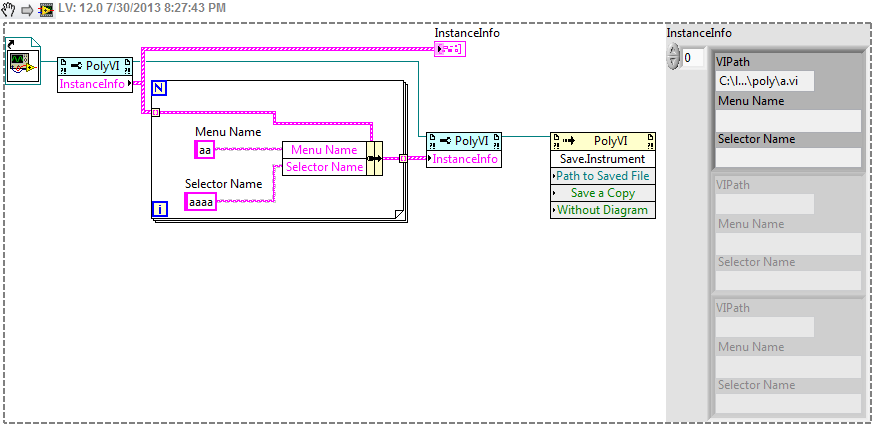

I'm sure it can't be this easy:
Message 3 of 9
(4,327 Views)
Oops, this doesn't add another poly.
Message 4 of 9
(4,324 Views)

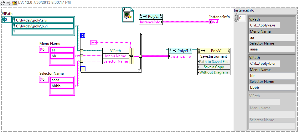

But this does:
Message 5 of 9
(4,323 Views)
Huh - didn't know about the instance info property.
I was trying the "New VI Object" which is how I was adding the first round of VI's to the new Polymorphic VI when first created.  I will try this and let you know.
EDIT:
Worked like a charm - would have made editing the Menu and Selector strings easier than what I ended up doing too.  THANKS!
