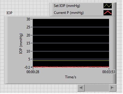

scrollbar for a waveform chart
Hi, I make the scrollbar visible in the front panel, but it's always gray out as shown below. How can I fix this? Thanks!

It's not autoscale. The chart only display the most recent data which is 3 minutes and 24 seconds long.

Your Chart History property may be too small to display more data than that.  Try setting the X axis scale so it only shows 1 minute of data and your scroll bar will probably work.  If you need more history right click the chart and select Chart History Length...  Change that to a much bigger number.  That number is the number of data points it will buffer.  Its default is 1024 which is pretty small for most uses.

So how many data point is in this 3:24 minutes?
How large is the chart buffer?
(5,649 Views)
It worked! I simply set the chart history length to a much larger number, 204800. Thank you so much!
