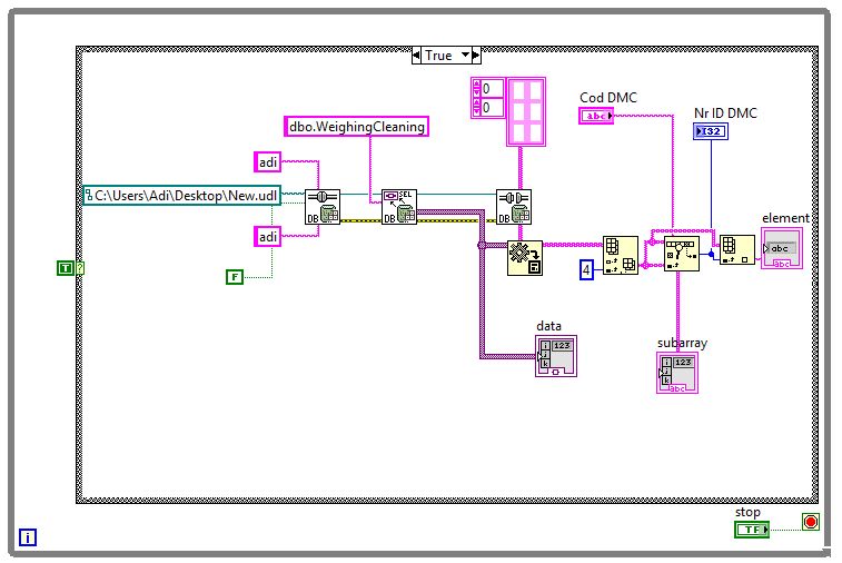

Hello guys,
I have a noob question.
I try to search with "Search 1D Array" function into an elemens of array.
In this elements I have same element in diferent rows.
If I run the "Search 1D Array" i receive only 1 index.
The question is:
How to find all indexes for that element ?1d array serch
Thank you for your help!

Hi a,
read the help for this search function.
Then use the 3rd input, which you have left unwired so far!
General comments/hint:
- clean up your BD, especially around the Search1DArray function: from your image it is unclear which wire is connected to which function input/output!
- Answer the question: Where should the search function start its search, when I want to find elements after the one element I already know?

Accepted by topic author Adrian_A
Use a loop.  The Search 1D Array has an input for telling it which index to start searching at.  So you can use a shift register to tell it to start searching at the element after the last one found.

In this case i'd loop through all elements and build a new array of the selected ones.

Hello GerdW,
I have read the help for search function. I want to start from index 0 because I dont know where will be the element (in wich row of column).
If you see, I read the  column 4 of the table dbo.WeighingCleaning and, in this table I need to find in wich rows exist my "Cod DMC" element. This element could be in more rows.
After I find all the rows I will be able to prind this rows and comapre the data.
Thank you!

Hi a,
please answer the last question in my previous post!
(And read crossrulz's message carefully…)

I want to search the first element after the one element that I have found. (if I have understood  your question)

Hi a.,
Right!
But why do you start to search at index 0 all the time?

Thanks crossrulz
With your solution I have solved my problem.

Because I dont know how to do that.
How to start search after the index that I have found ?
