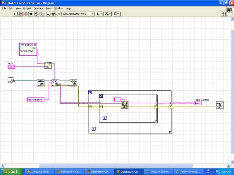

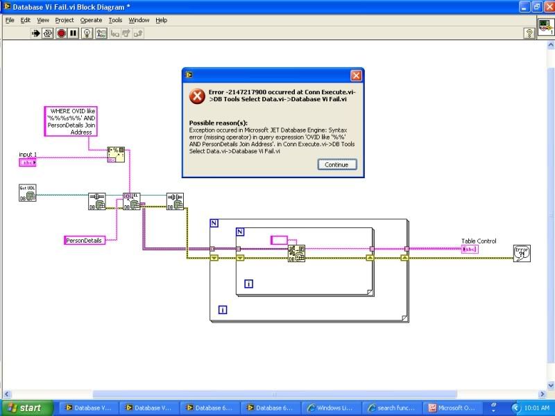

Hi, the first picture below is the vi which i have attached in the first post. the second picture is the error which comes out after i run the vi. im not really sure if i use the join clause correctly.
[IMG]http://i93.photobucket.com/albums/l65/vittoire/NewPicture.jpg[/IMG]
[IMG]http://i93.photobucket.com/albums/l65/vittoire/NewPicture1.jpg[/IMG]

No, it's not correct. Did you look at the link from smercurio_fc? Since you are using Access, you can also have Access show you the correct SQL syntax. Design a query to return the data. There is then an option to show SQL. I don't remember exactly where the option selection as I don't have Access here and actually have not used anything other than SQL Server or Oracle in quite a few years.
p.s. You also have to have a relationship between the two tables before you can do a join.

Something like:
SELECT address.address, personaldetails.FirstName, personaldetails.LastName
FROM address
INNER JOIN personaldetails
ON address.AddID = personaldetails.AddID
