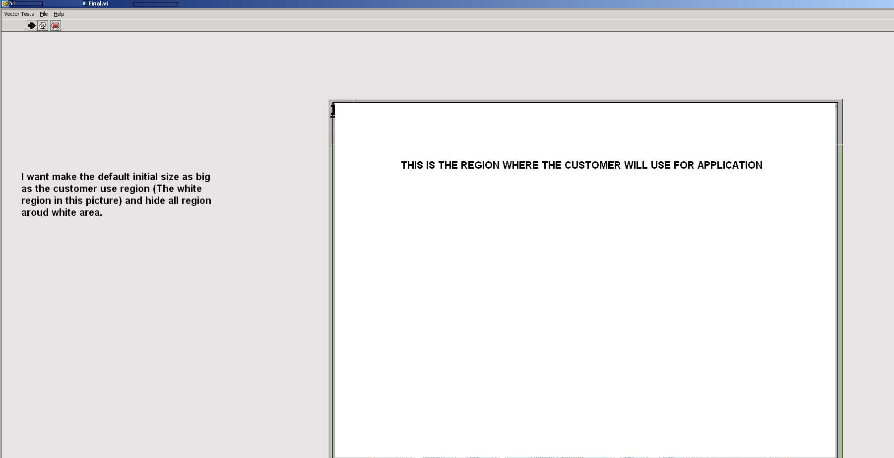

I have a question about how to define the size of exe program. When we use our code and conveter it to exe, the size seems to be fixed. But sometimes that is not presentable to present to customer. For example, in the attachment1, that is current exe file's default looking when it is started.
Thank you!

Have you tried setting the values in the VI Properties -> Window Size section?
If I remember correctly, there is also an OpenG VI that will set the panel to the largest decoration on a front panel. You may find that useful.

The link I provided you was incorrect. The correct link is : http://wiki.openg.org/Main_Page
OpenG is a set of libraries that are installed using the VI Package Manager.
