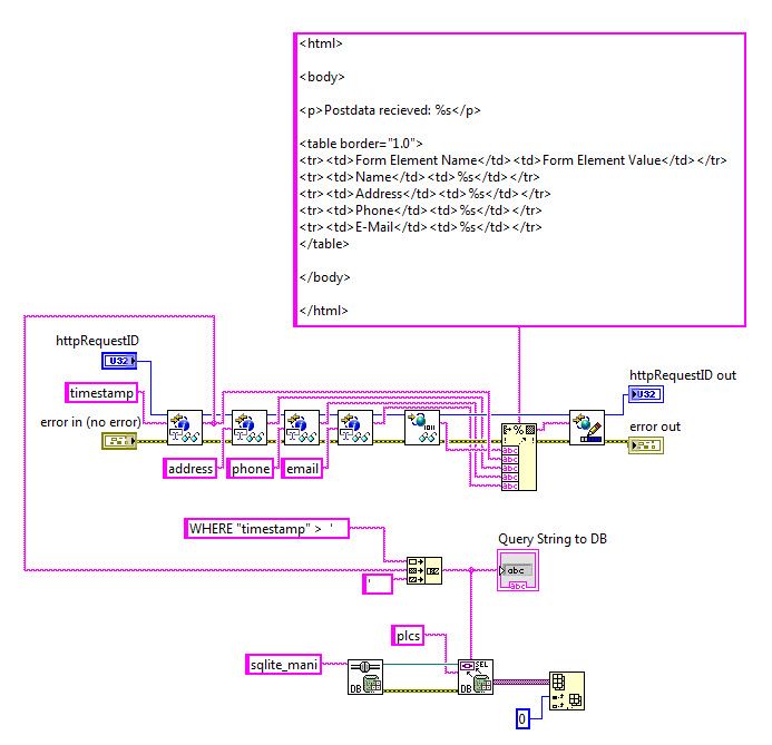

To do this, I downloaded the HTML_Form_Example.zip and executed it in labview. Everything is working fine and as expected. I modified it a little as following:
I used the "Labview Database connectivity toolkit" to access a database and fetch some records. I will write the fetched data to a file (I have not done it yet, but I know how to do it).
My question is this: Having generated the file, how can I send it back to the user's we-browser?
Should I use the POST VI to do this.

Typically a web based interface doesn't send files, it rather provides a download link. So you would generate the link in your page and save the file to the place on your webspace the link points to.
Cheers
Edgar
(3,081 Views)
Thank you ejkaiser. Thats a good idea. I can generate the file and save it into the web server folder. Then I can display the link of the file in the page, and user can click on it to download the file. The problem is that where is the folder that stores all my files for the web server?
Is it, C:\ProgramData\National Instruments\WebServices\aws ?
