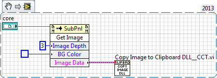

We used some free VIs from Rolf Kalbermatter to do this in the Code Capture Tool. The tool itself is released in 7.0 format, but the VIs will also work on older versions if back saved.
Yes, this was useful for me. I was banging my head against the problem until it occured to me that there must be a VI I could pull from the CCT to handle the saving of a LV Image to clipboard. The format is device-independant bitmap, which is just fine.
 The VI is named "Copy Image to Clipboard DLL_CCT.vi".

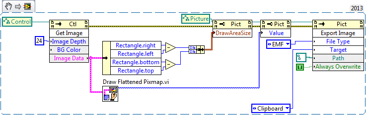

That should work for any control (or indicator) to capture the image and dump it to clipboard.  It doesn't call the Windows API at all, or rely on any external DLLs.

@BowenM wrote:
However, this is NOT a true VECTOR image, but a EMF wrapped BMP file.
Get Image method returns PIXELs.
George Zou
