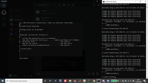

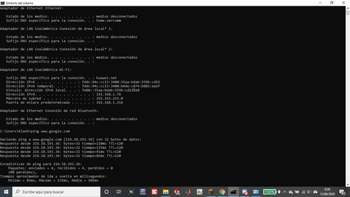

When I ping to google there´s no problem but when I ping to other IP adrees that is not in the same local network it times out
At left I have the IP adress I am sending the ping and at the right, there´s my command window, both computers have firewall off... and there´s no conection, help please
This is my own ip adress

This may sound rude, but you lack basic understanding of IP addresses.
I recommend instead having two computers connected to the same router or switch, and communicating between them. If that works, it will also work across the Internet, if you have external IP addresses.
You can reach that google server because it has an internet address.
Whenever you seen an IP address starting with 192.168, you are dealing with a local address. That address only makes sense to the router your computer is connected to, and other computers on that router, and nobody else. You cannot use that IP address on different routers, and send data.
Trying to address a computer on another network using a 192.168.*.* address is like going to your post office with a letter addressed only to "Mr. Smith". There are tons of Mr. Smiths.
My IP right now is 192.168.56.1. There are only 255*255= 65025 in the 192.168.*.* range. Do you think there are only 65025 computers in the world that are on that range? There are millions, if not billions.
You should follow my advice, because like I wrote, it if works then, it will always work.
