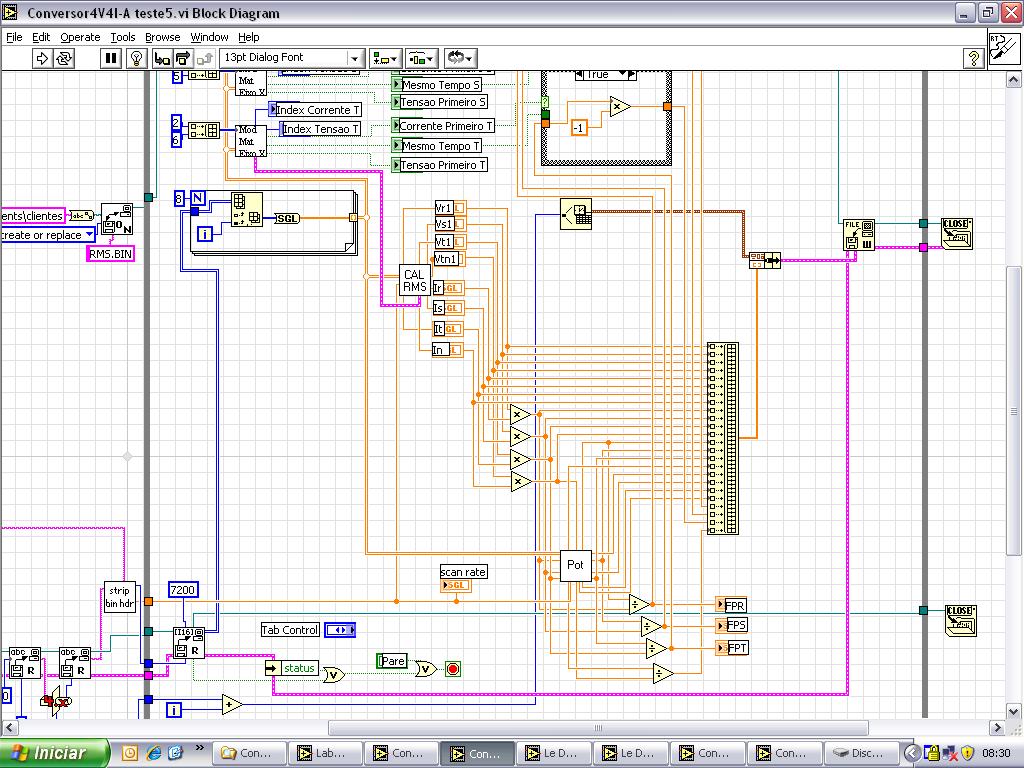

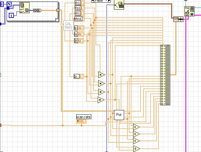

Hey mercurio... I thought my mistake was at local variable...
but today I fixed it
and still getting me crazy values.
So now I will upload a screen from my real code so maybe you can see any difference!
This works:
and this don't work:
The only thing I changed is because before I send the last 4 elements... I check a case strucuture and modify this values...
but when I see in the other program... I get crazy values.... and in the first picture it works correct! -.-
If anyone know why it happens, please help me
Message 8 of 10
(5,351 Views)
