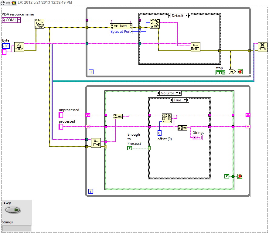

I'm looking at the picture from post #14, and a couple of ideas come to mind:
  1) Probe "Bytes at Port", or wire it out to an indicator. This will allow you to see how many Bytes are being read each time.
  2) You are using "Wait Until Next ms Multiple" instead of "Wait (ms)". Multiple might only wait 1 tick, while Wait (ms) will always wait that many milliseconds. (Not a big deal, just be aware.)
  3) If "Read String" gets larger each loop iteration, and there are a few functions processing it each time. If "Read String" gets large enough, the loop may start slowing down. One way to defeat this is to send the string to another loop for processing:
Message 48 of 62
