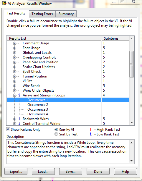

A quick trip through the VI Analizer points out a few potential pitfalls
Some of that file handleing needs to get spawned off into a sub.vi and references to files need to get closed!
Most of those True False case structures could be replaced with select functions.  I really don't understand the loop with the trigger and gate function and the statistics express vi configured to return total samples when you want the value of index 1.  All those dynamic data conversions and express vis are going to bloat memory as well.

I don't have the VI analyzer, can you tell me what other occurrences it found as potential problems. I moved the concatenate strings outside the while loop, to see if that helps. I keep making adjustments and deleting things I think are an issue and still keep getting an error for samples and the memory skyrockets to 4GB

Fair enough.  (But you should seriously consider an upgrade to your development enviornment!)
 The results may not do much for you though without running it local to your vi
[EDIT] Oh, Come ON! I can't attatch a *.txt file????

OK Attachments work again.  Lets try again

Thanks for that, some useful tips on what I am doing wrong.
