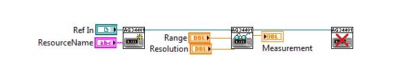

Instead of using a global variable, I believe it is easier to use a simple indicator and then pass the refference from one VI to the Next as in the following image
I even added some descriptive images and changed some constants to controls so that you can modify some parameters while running your program
Could you try this out? I reattached the library.

Hello Marisol,
Thank you for the modified library, but I can't use the VIs in that way because the execution is done without a fixed top level VI that connect all the other ones.
The way they share the information is with global variables between the VIs. But for some reason the global variable of the Automation Refnum generates error, I already tried with a string global variable to store the Resource Name and that works but i have to open the reference and initialize the instrument inside each VI so the driver recognizes which device it is going to communicate. I would like to avoid that open/initialize part for all the VIs.
