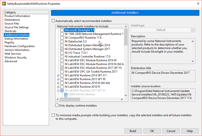

I then want to port the executable to a deployment PC, installing only the application and the required RT engines. For that I have an installer build specification in the project. I took care of tagging the following additional installers: DSC runtime 2017, all LabVIEW runtime 2017, Variable Engine 2017.

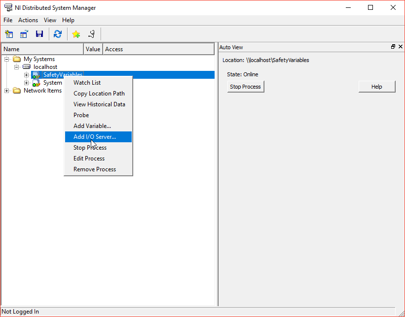

Adding more information. I managed to install the NI Distributed System Manager also on the deployment machine, and I see that when the executable is launched the shared variables are deployed, but not the Modbus server they are bound to. On the development machine instead, it is regularly deployed. This explains the observed behavior.
A further confirmation that something is missing is that right clicking in the NI-DSM I would be able to create a new i/o server on the dev PC, but not on the target.
However, this still doesn't tell me what I'm missing. In the installer build specification I'm tagging all installers which look relevant, that is NI-DSM 2017, NI-DSC runtime 2017, the whole LabVIEW runtime 2017, and NI Variable Engine 2017.
I wasn't able to find on the NI site any indication of possible missing installers. I thought at DSC on the target machine, but that would install only on top of a LabVIEW IDE.
