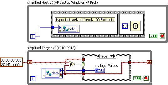

Host VI:
In a host VI on my Laptop (HP with WinXP Prof.) i'm writing data to the shared Variable "data". Between two consecutively write operations is a minimum of Milliseconds waiting time. I use that because I want to be sure that the timestamp for each new data value is different then the preview one (resolution shared variables is 1 ms)
Target VI:
the Target VI on a cRIO-9012 realtime device is reading only new data in the way that it compares the timestamp of a new value with the timestamp from the last value.
Problem:
rarely, I'm missing a datapoint (sometimes everything works fine for several hours, transferring thousands of data correctly before suddenly the failure happens). With some workaround I'm able to catch the missing data. I've discovered that the missing data has the exactly same timestamp then the last readed datapoint, therefore is ignored in my "legal" data.
To sum up, the missed value is written to the shared variable in the host, but the target ignores him because his timestamp is wrong, respectively the same as the last value has, despite the host waits every time for a minimum of 10 milliseconds before writing a new value.

Simplified Example:

The problem in fact is simple. I don't really lose data, but I read two consecutively data from the shared Variable which both have the same timestamp, despite I wrote this two data with a minimum of 10 Milliseconds time difference between each write cycle.
According to the LV documents, the time resolution of shared Variables is 1 Millisecond.
Who is finally responsible for writing the timestamp to the shared Variable, LabView or the operating system ?
Is there a minimum time difference I have to wait between two write cycles to have a guarantee each data when reading have a different timestamp ?

there is still some misunderstanding about the real problem, I'll try to explain it in other words.
First of all, I'm not using the RT-FIFO, but that's nonrelevant now.
Imagine the Host-VI runs for 1000 iterations. What do we await  on the Target-VI?
Imagine the "my legal values" as an array, collecting all values with different timestamp, filtered out whats duplicated, like you described it. The result should be an array like that [0,1,2,3..999], right?
I tried exactly that, and the result was exactly what I awaited, so far so good.
BUT, not always!
Sometimes my array "my legal values" looked e.g. like that [0..123,125..999] !?
Where was my (index-)value 124 ? I've found the value in my "ignored values" , filtered out, because the value 124 had exactly the same timestamp as the value 123 !
(please have also a look at the simplified example above to understand what I mean with "my legal values" and "ignored values")

I had a look into our CAR (Corrective Action Request Database) and the issue with the timestamps is in work at R&D. If you would like to foolow up just ask AE´s or DSM´s from NI and give this number: #125640. That´s the ID of the CAR.
I would prefer to program a workaround with a array, to catch slower the values (10 times per second a communication) and perhaps implement a kind of ID, to know which packet is arrived.

This issue has been resolved in LabVIEW 2010.  You can check for other bug fixes in the LabVIEW 2010 Readme.
