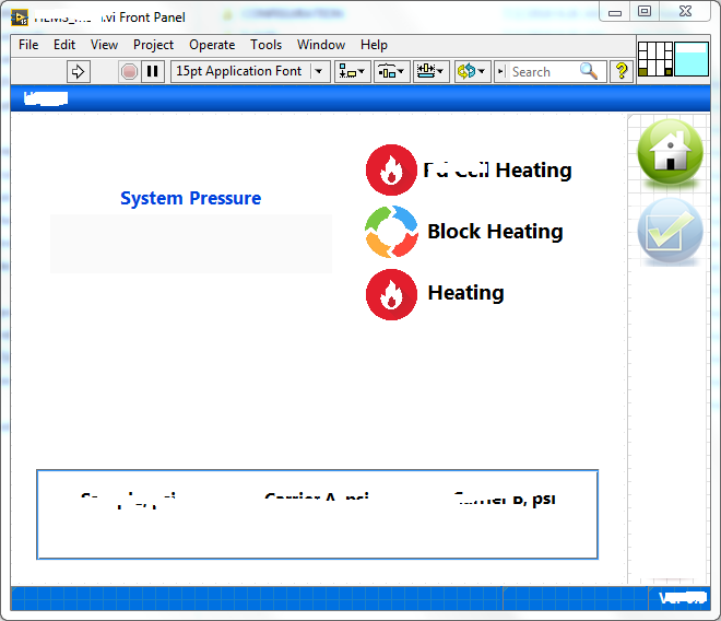

this is the front panel
pane #1 is the blue bar at the top
pane #2 is the blue bar at the bottom
pane #3 contains the icon buttons on the right
This program eventually is suppose to run on NI TPC 2206.

@altenbach wrote:
Is the control colored transparent?
No, it is not.
I have found to get to the indicator I have to unlock the splitter and add a vertical scrollbar to pane #1.  Make changes to the indicator, remove the scrollbar, and resize the front panel back to 640x480.

@RavensFan wrote:
What if you used property nodes to change the position for that indicator?  Just run it once.  Perhaps move it to 0,0.
I will give that a try but perhaps to a different coordinate.
Doesn't 0,0 refer to the top left of the front panel?
If so, that would be in the top pane which is 20 pixels in height.
This cluster has 15 elements displayed vertically so not all of it will appear unless I size the front panel to 1000 x 800 or something like that.
It doesn't look like I have any choice except to re-size the front panel to get access to this indicator and then re-size the front panel back to its original size.

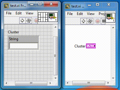

If I'm understanding the problem correctly, you can try:
  1. Right-click cluster on BD -> Make Type Def.
  2. Right-click cluster on BD -> Open Type Def.
  3. Edit cluster (set Strict if necessary)
  4. File -> Apply Changes
  5. Change Type Def / Strict Type Def to Control
  6. Close the cluster and don't save it - this will disconnect your cluster but keep any changes, and discard the type def
  7. Your cluster is now updated

Accepted by topic author nyc_(is_out_of_here)
I just ran through the steps in LV2015 SP1 and it seems to work (no need to save a .ctl file). Here's a quick gif of the process in case my steps weren't clear:
