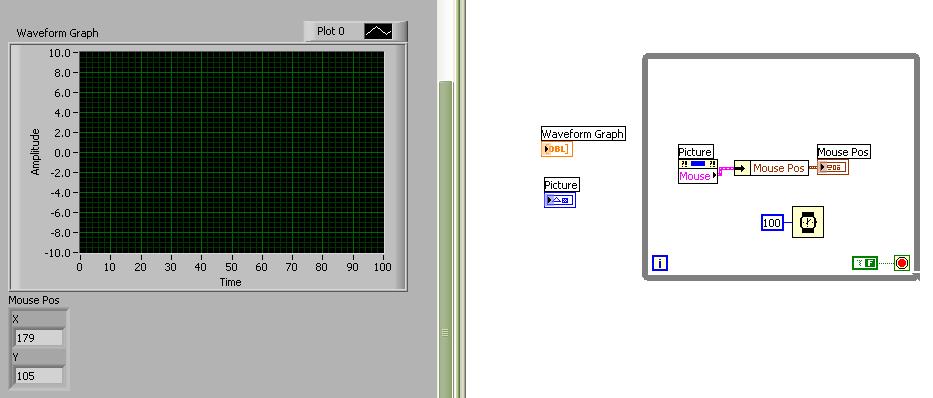

hi all
i was thinking how could i make it possible to make the chart or graph tells me the value of a point on the plot when just pointing at it....
and is it possible to do the same with the report generation tool kit (in excel).
thanks

That is how we had to do it "back in the day".
Modern version of LV have;
1) Mouse Move Event which will return the coordinates of the mouse that can be passed to the...
2) WFGraph Invoke node "Map Coords To XY"
and when combined...
We have a nice easy way to determine what the actual XY values under the mouse.
