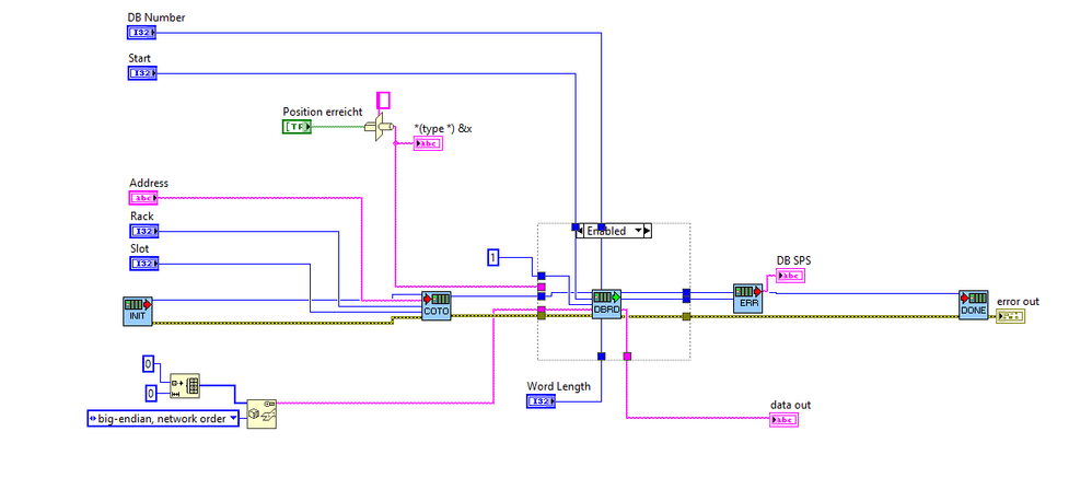

thank you for replaying.
i used already Snap7 for reading and writing data from/to data block with disable optimized access and works will.
i want to access the daba block with simbolic form like "DB_OperationMode.setting" instead DB100.DBX10.0.
is it possible with snap7 or something else?
