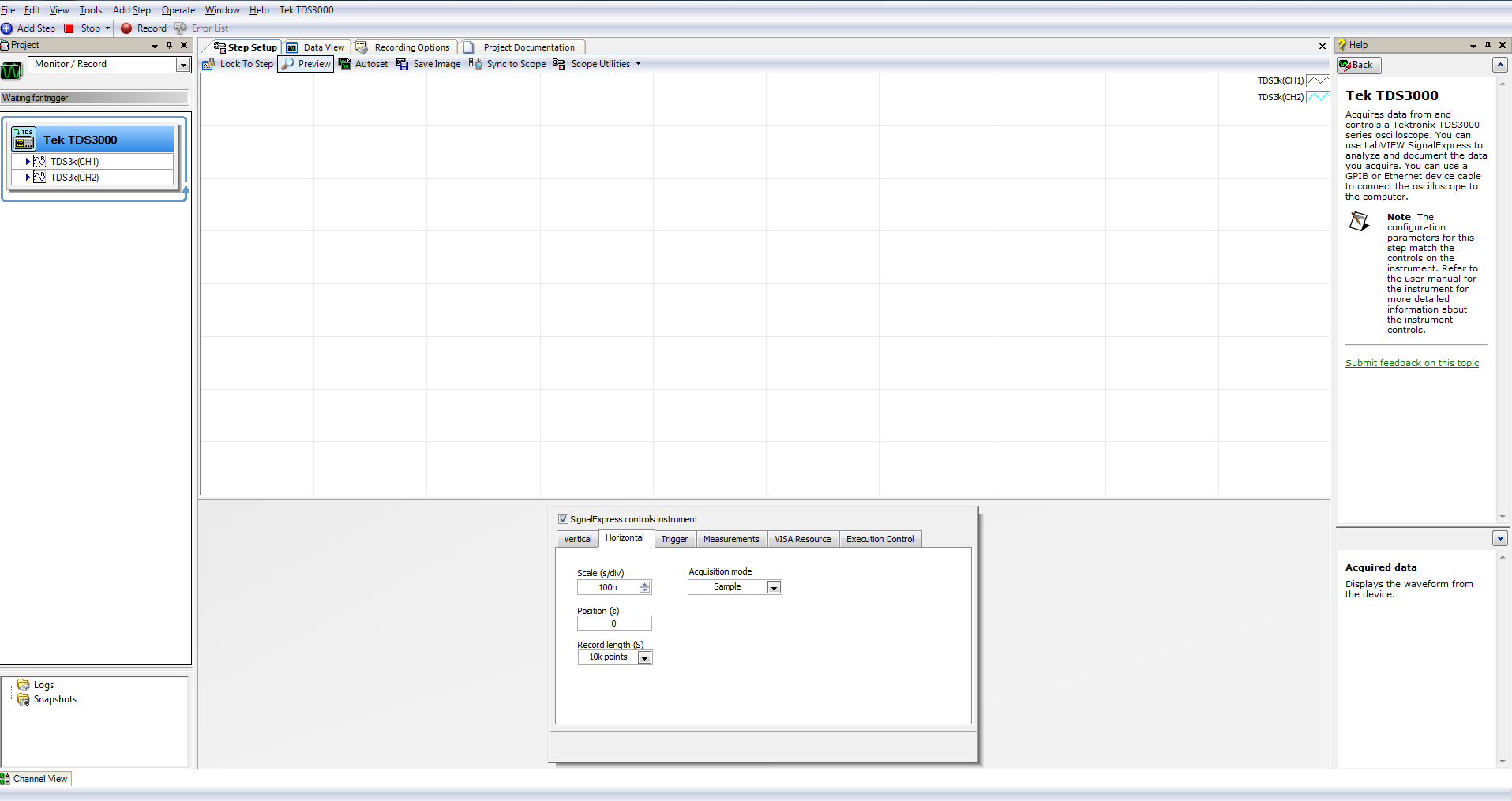

    I can see my instrument listed under MAX so that means I can communicate successfully. However, when I ran the Signal Express Tektronix edition, I cannot see the signal on my computer. I have posted screenshots I think they might be useful.  When I clicked run, the program is just "waiting for trigger" but I can't see anything on dataview. Maybe I set up the trigger wrong? Please let me know if there is anything I should try.

Hi Taylor,
    Thank you for replying. My current setup is that I connect my oscilloscope to the hub using ethernet cord and obtain IP address. Then I use my computer and open the Signal Express Tektronix edition to view the signal from oscilloscope. Also, I'd like the data acquisition to start collect data right after I click "Run".
For the error, sometimes I still got the same error, sometimes it went through. However, when it went through, it's waiting for the trigger forever. If you have any suggestion and anything I should try, please let me know.

Hi Taylor,
    I've attached more pictures of my setup. I tried to change the trigger type from "edge" to "immediate" like you suggested last time but there is no option to choose. For now, I just want to set a trigger to some value and detect any signal that is greater than that. Could you explain me how to set up the trigger?
