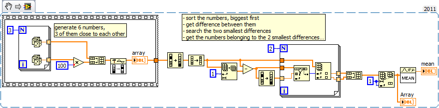

I am generating a stream of six numbers where three of them are spaced out quite evenly whereas the other three will be clustered quite close to one another. Can anyone suggest a method that will find the average value (or centroid) of the cluster of three? I have downloaded a clustering VI but I'm not quite getting the results I am after and the documentation isn't very good.

Hi Jack,
this could be a solution:
I don't claim to offer the most optimized solution, but it seems to work for me.
The main point is: you need to learn to develop an algorithm to tackle your problem. See the comments given as explanation in the snippet!

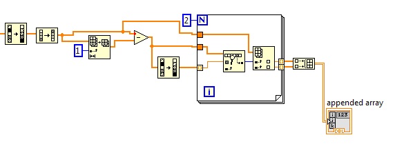

Thats great - exactly what I was looking for. Just on query - when I have tried implementing this myself I have found I get a 2D array on the output from building my array as shown here. Do you know why that is happening? Cheers

Hi JNaumann,
right-click is your friend!
Right-click BuildArray and choose "concatenate arrays"…
