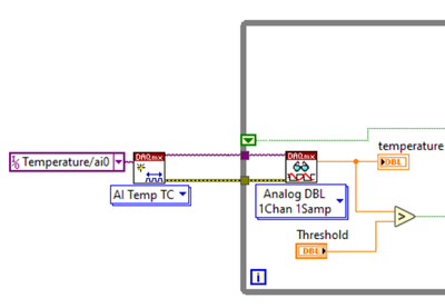

I have just created a VI which acquires a temperature from a simulated USB 9221 card.
I attach a pic of the code.
It works fine but I would like to see the temperature which changes from time to time (it's more realistic). Now it remains constant.
Is it possible to do that in Labview? Thanks

Simulation within DAQmx is pretty much limited to sine waves.
What you can do is replace the DAQmx read with a subVI that outputs data in whatever way you want it to vary from iteration to iteration.
