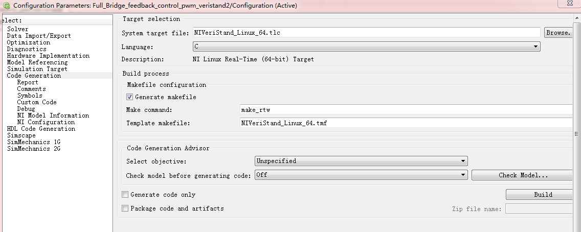

Excuse me, but I have a similar problem that cannot be solved by the same way. I've installed the Eclipse2014 in my computer E:/NI/Eclipse, but when I'am trying to build an .so file for Labview in Simulink, like the following picture:

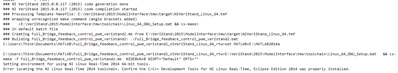

Here comes the error which says:
And what makes me confused is that even after I unistalled the Eclipse2014 and repeat the same process, the same error happens. So is something wrong with my installing process of Eclpise?  And I note that after I installed the Eclipse from http://www.ni.com/download/labview-real-time-module-2014/4846/en/ , there is not such file folder as "Toolchain" in the position where it is installed. And I don't know why either.....
