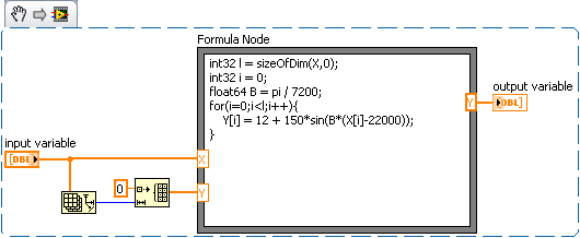

Hey can you attach a vi that successfully implements the sine function in a formula node?  I need to make:
12 + 150sin(B(X-22000)) where B =  (Pi/7200).  Please help me out with this, and it has to be in a formula node to fit into my project.
Thanks for any help.

Kind of - a class project.  Is there way to put a simple sine function inside of a formula node or not?  If not I need to do some major rewriting.

Hi SMLion20,
The code below may help you:
