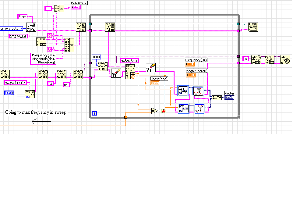

That's not really a driver and why would you think you need to use the property node in the first frame? You are also discarding a lot of the error connections because of the way you are using a sequence structure.

Hello sir,
This is not a driver but we can control the FRA for their own purpose. I am trying to make this as a control driver. In my labview software IDE is not working or I didn't download any module for this purpose.
The property node is not required, I thought, i clear all the visa and also I closed the visa. so primary address setting is better in this case.
  I cannot solve with higher timedout  in VISA read and also in Scan from string palette..I tried in VIsa read 2S,10S, 20S etc. all the case same error it is showing( default is 2S). So I use clear message.

You are probably getting the error because the instrument does not assert EOI and instead uses some pre-standard termination scheme. The driver for the 1260 does something similar. Changing the timeout value will do nothing.

hello sir,
I don't know about the pre-standared termination scheme. (This by self study only). I never gone to inner parts of LabView.
I already tried with 1260 driver some months back. At that time it was showing some errors. I think it was in the
Initializing palette. I will try once again.

The termination has nothing to do with LabVIEW. It has to do with the IEEE-488.2 standard. There is a management line on the bus called EOI (End Or Identify). The standard adopted in 1987 made the use of this line mandatory. Before that (or even later if a vendor did not care), the EOI may or may not have been asserted after the last data byte. A different scheme of terminating with CR, LF, or both may have been used.
You would of course need to modify the init function of the 1260 in order to recognize the 1250.

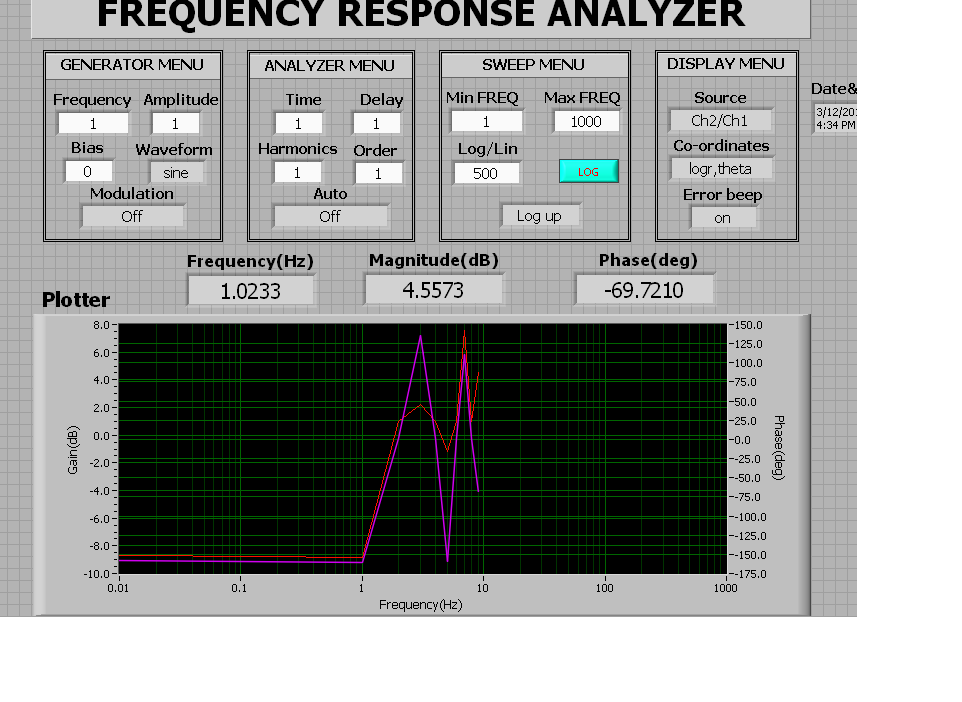

Hello everybody,Listen this!!! This is not a driver but we can control the FRA
 Thank you everybody
