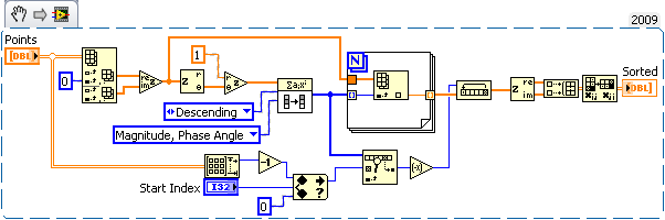

Here is one way to do it.  The key is the Sort Complex Numbers VI.  The shift is so the Sorted Array starts with the element at location Start Index in the original array.
21177i86245E3962A1CEA1

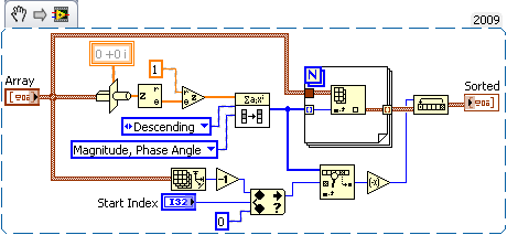

I misread how you stored your points, here is a VI version which uses a 2D array along with another snippet.  If you have LV2009, you can drag these pictures to your BD and the code will be placed.  If you do not have LV2009, the VI I attached won't be much more help and you will have to let me know which version you are using.
21181iA83B58B5E7C9881C

Mine is 8.5.1. Drag/Drop doesn't work here.

Thank you. This is not sorting them clockwise tho b/c the center is not always the origin. I believe it'll work tho if I move the center to the average of the points, do the sort by your VI and return them back to where they were. I'll try to make it work.

Ok, this is not working unless if we are able to make it sort just by phase angle and I can't find that option here. Do you know how to do that? I attached my file.

It appears to work for me.  Notice how I set the magnitude to 1 before sorting, this makes it sort only on phase.  You may want to graph the points, along with your center point to verify.

A few ideas to simpify the code. I don't think we need to pull out the big guns to sort complex numbers if all we are interested is sorting the phase, which is a plain DBL array. 😉
Here are a few code draft fragments. Of course you should put Darin's code back in to get the rows of the 2D array and to rotate the array to shift the origin around. Also note that if you built the final array inside the loop, you don't need to transpose. (Sorry, the snippet is 2010, but the attached VI is 8.5)
