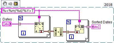

Try this, May be others can suggest easy conversion.

They are ordered as strings. You need to convert strings to Timestamps before sorting, using Scan From String with format string %<%m/%d/%y>T

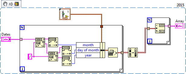

My solution is similar to Paul's.  It just avoids the conversion back into a string.
