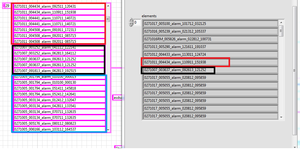

if you get the elements on the 1st 2 squares i showed on the picture and run it you should get 2 elements output (1 of every block on the picture)
be more specific than what i have already been
lets see, many blocks (picture) on an array each block is a directory, I want to output 1 element/block the latest.

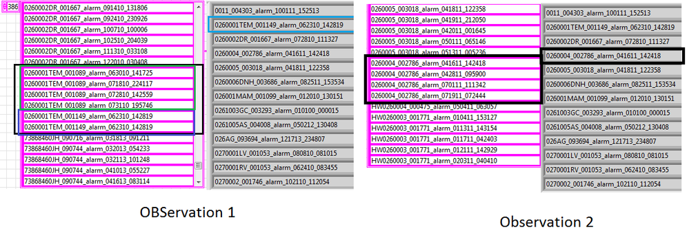

Crossrulz,
I found 2 different discrepancies (not sure if the only ones) and they can be observed on the picture iam attaching.
Observation 1: there are two different bicycle s/n for the same name, and the program only picks latest on one (1).
Observation 2: (There is only one bicyle s/n) and sw fails to pick the latest .
regards,

Then edit my code.  The issue is in the last loop.  Change the logic for which items to keep.  I just did the comparison on the name since that was what you told me to do.
I was thinking about this last night.  The code current picks the oldest item for each name.  The really simple solution to this is to reverse the array after doing the sort.
