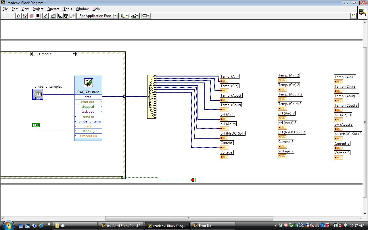

Let me explain ab bit better:
On the block diagram:
I have one DAQassist that is acquiring about 100 signals. I wire the DAQassist to a signal splitter with 100 splits and then I create 100 numeric indicator for each channel.
When I do this, the big problem is that I don't know which channel is which; the numeric indicator doesn't show the name of the channel.
I am looking fior a way to sort the channel whitin the block diagram so I know which channel is which.
I hope that this help, I will post a picture of what I have done so far...

This is the mess that I came up with:
Ass you can see there should be a better way do do this. I guess that I will try what you just said, although I am not really good using tasks.

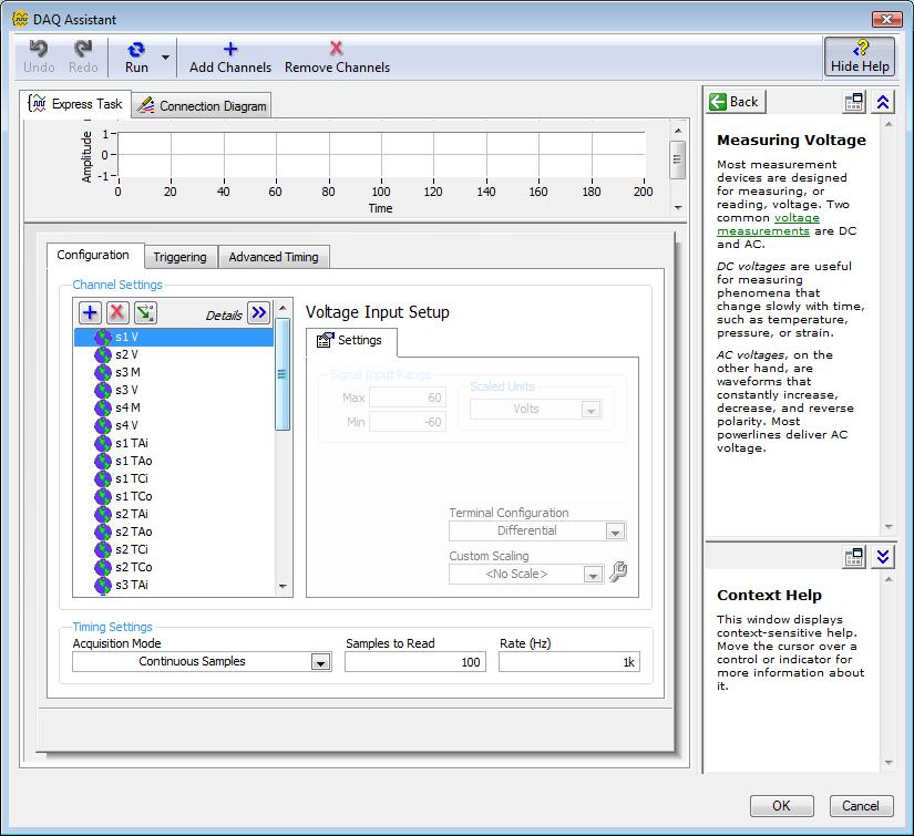

This is the DAQassist :
