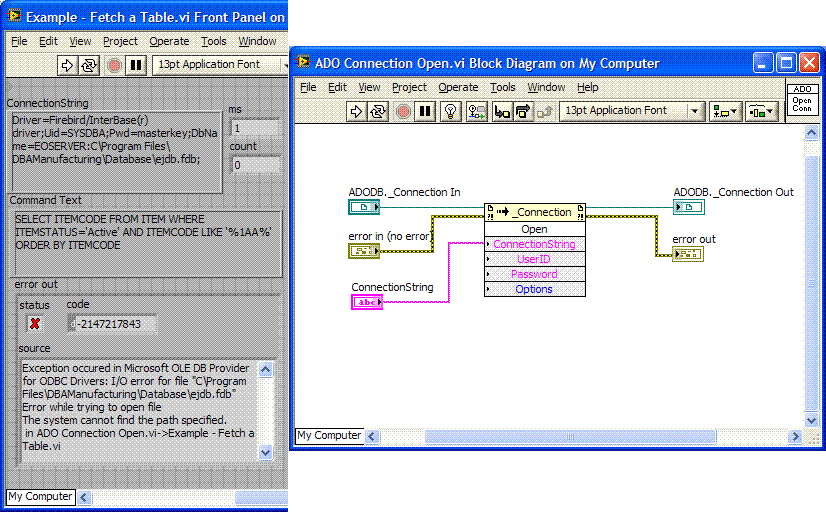

Its a Firebird Database on a Server inside my building.  Here is the screen shot of the connection string and vi block diagram.
Connection String

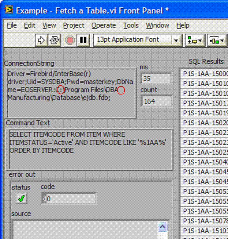

Sorry, I had a few typos.  Missing colon and missing space in my connection string.
Connection String

I take it from your screenshot you successfully SELECT'ed some data out of your DB?

Yes, I did get a successful data set from the database.  AFAIK firebird is a free database that can do many things.  There are books on it, but I don't have any experience with managing databases.  I just want to read certain information and put it into a report.
