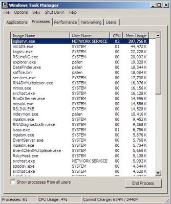

sqlservr.exe nealy 300M of memory at boot and growing
The sqlserver.exe service installed with the DSC module in LV 8.6 on this computer.  Pretty much right away I noticed serious performance issues with the PC.  The hard drive was thrashing continuously, and memory was being gobbled up even when little or nothing was running on it.
This screen shot is taken right after boot.

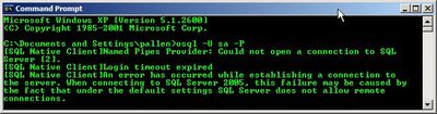

Thanks for the link David.  This is along the lines of some other links I found about changing the memory allocation limits.
Unfortunately, I don't seem to be able to establish a connection to the sever through the command line.  I don't recall ever creating a password here.  Am I doing something wrong?

Hi Patrick
That's the same error message I got, but I could log in and change the memory settings using the application I linked in my last post. There it by default used my Windows username and a blank password to log in. It also specified a server name as "mycomputername"\SQLEXPRESS. So I tried using the the command:
C:\>osql -S LAPTOP\SQLSERVER -E
That got me somewhere, just need to find the command for changing memory allocation. But like I said, it worked using the Microsoft app.
