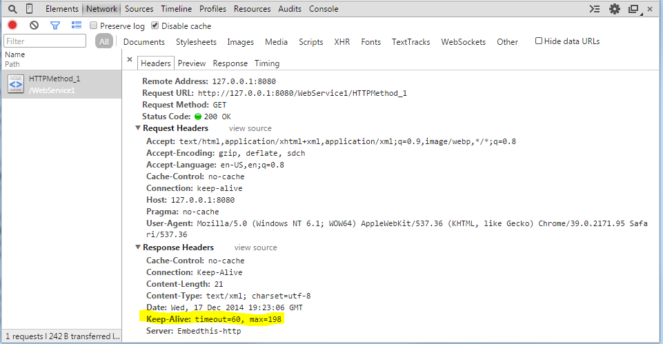

If you capture requests to a LabVIEW 2014 Web Service in the browser (like using Chrome Developer Tools) you may see something like this:
If you take the server field and make a clever Google search for "Embedthis MaxKeepAliveRequests" you might see this: https://github.com/embedthis/appweb-3/blob/master/all/appweb.conf

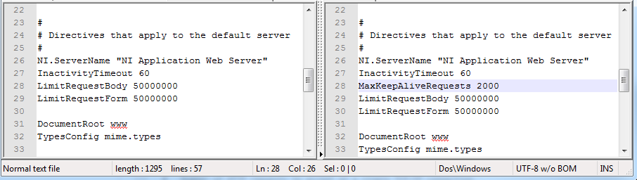

If you found a Shared NI WebServer file named NIWebAppServer.conf that looks somewhat similar to the other file, and made a backup, then you could add the following line and restart the computer (or restart the NIApplicationWebServer service):
If after the computer (or service) is restarted you went to chrome and tried again you may see this:
If you don't see that or if you broke everything, be glad that you made a backup, and whoopsies.
